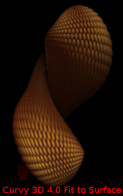

Model a design in the flat, then warp it onto a surface to get a sophisticated look with minimal effort.
This is just my first test - but I can't wait to try it out on real models. Any sculpture detail that would be easier to model flat then warp to a curved surface.
At the moment this works on the curve based Curvy Primitives, but I am working on extending it to any model with a UV map.

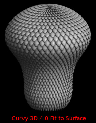

Re: Warp to Surface
You can use fit to surface to create "3D textures" like these individually modelled scales wrapped over a 3D surface. This example is quite subtle, but you could map any geometry to any surface.
Image Image Image

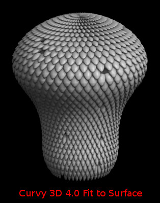

I added a "weathered" version to show it isn't just a texture. And another with Fit to Rails.

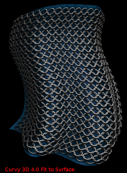

Re: Warp to Surface
Another one I wanted to try, chainmail:
I think if you could remove the stretching if you were careful with the curve lengths.
