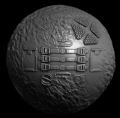

Using the Custom/Stamp brush to add hard-surface alpha brushes to a 3 million tri sphere.

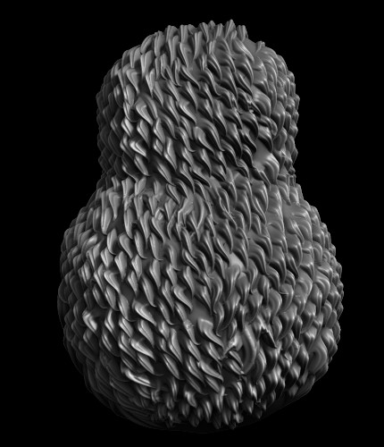

More hi-poly stamp testing. This time on a 5 million triangle mesh and alpha brushes bought from Artstation. There is no sculpting here - just stamped alpha brushes.

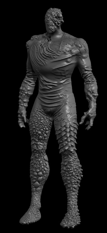

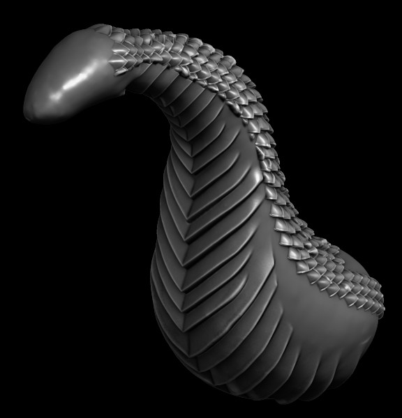

Dragon scales and torso test with selection masking.

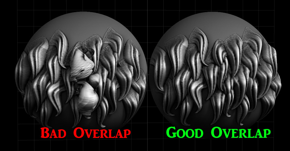

I've added a layered stamping mode to allow you to fill in an area with stamps, without them adding on top of each other and making a mess.
In this example two stamps are placed overlapping. On the left the second stamp grows off the convulted surface of the first making nasty bubbles and stretched areas. On the right is the layered version which allows both stamps to displace the original surface without interference.
Similarly to the simple Layer brush, once you have begun sculpting in a layer you can also erase your strokes back towards the original surface position. This should help with blends and fine tuning your stamps.
Holding down the right mouse button lets you change the size and orientation of the custom stamp as you go and fill up a larger shape.
