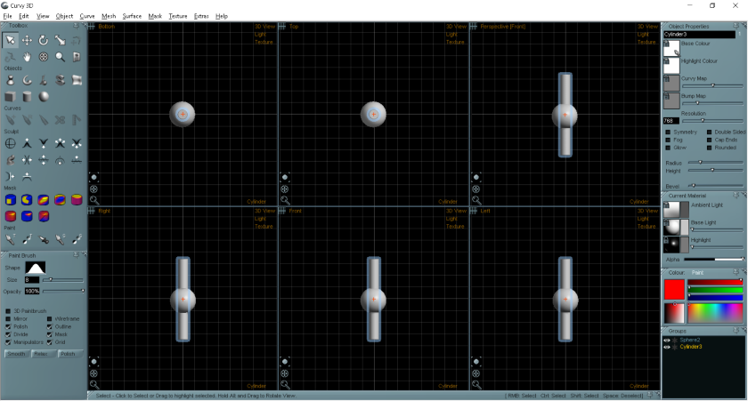

I am trying subtract from parent and wanted to know how I determine which part is the parent?
I have a sphere and a cylinder (small diameter longer length) which I have placed into the centre so all views show the cylinder is going through the sphere.
I pressed k to do the mesh
If the sphere is the parent and I want to do a subtract from parent which one do I select and when do I use the mesh, subtract from parent?

Re: drill a hole
Drag the cylinder onto the sphere. This makes the Sphere the parent, and the Cylinder the Child.
Then with cylinder selected use "Mesh/Cut from Parent"
If they are aligned nicely the cut should be neater than this example.

Re: drill a hole
You don't need to convert to mesh, it happens automatically.
Only thing I can add to the steps above it to make sure that drag and parent happens OK in the groups panel. You should see a "-" by the Sphere, and moving the sphere should move both objects now. Then with the cylinder selected use "Cut from Parent"

Re: drill a hole
OK, there was no - next to the sphere in the groups list.
Moving the cylinder over and to the right of the sphere made the minus appear.
I did try object group after using Ctrl and select each object but that did not seem to do the same. I did expect it to.
The hole crafted into the sphere is as round as yours.
Can I smooth the edges somehow?

Re: drill a hole
If you show the wireframes, you can adjust the radius of the cylinder a bit so it cuts through the middle of the triangles, rather than skirting close to the vertices. Then the cut will be more even.
