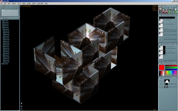

simple
inflate a simple 256 square white bmp to get a pane
texture it with any texture (it can be changed later)
copy and paste panel 4 times and rotate panels to form a room
save it (so that you can use it for future projects)
group the panels then copy this group as many times as you want
drag groups rotate etc to block construct your building.
re-texture panels, curvy map etc as required

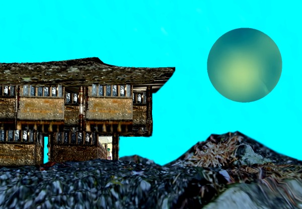

We have rapidly built our construction but notice because it is made from numerous panels we can adjust the lighting for each panel
and light up rooms at will. :)
example
