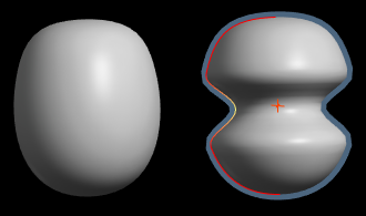

1.5. Soft Move
Drag to Pull part of the item, deforming the rest smoothly. Works on objects and curves.
You can choose the shape and size of the soft move effect using the Tool Controls.
Drag on the white Shape to change from a pointed to a flat effect.
Drag on Scale to control the size of the effect on Curves.
When you use soft move on Objects the effect size is controlled differently - hold Ctrl with soft move active and drag in the view to scale the effect.
You can also use the Set Tool Size tool from the toolbox.
Hold SHIFT and drag to move the part in and out of the screen, towards and away from the viewer.
