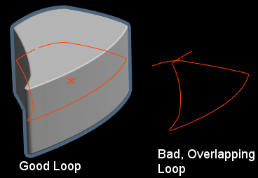

2.3. Create Blob
Draw a Loop to create a rounded object.
Make sure the curve does not overlap itself. It should end a short distance away from the start point for best results.
See Also: Blob Tutorial
Draw further loops inside the first to cut holes into the blob.

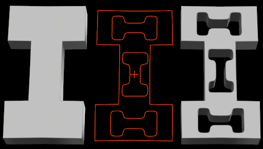

2.4. Create Slab
Draw a Loop to create a flat object.
Make sure the curve does not cross itself. For best results the end should be a small distance from the start point.
See Also: Slab Tutorial
Draw further loops inside the first to cut holes into the slab.

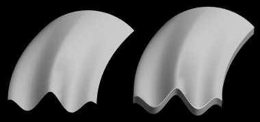

2.5. Create Loft
Draw three Curves in a H-Shape (Centre line first) to create a thin surface.
Or draw four curves to make a square.
3 curve Loft order
4 curve Loft order
You can also add depth to a Loft using the Object Properties depth slider.
See Also: Loft Tutorial
