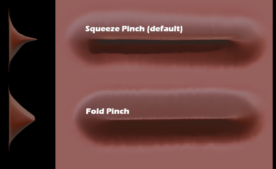

Fold Pinch
This toggles between two different Pinching styles that are used both by the Pinch brush, and by the other brushes when they are set up to pinch as they sculpt with the pinch slider.
The original pinch squeezes the mesh together creating a look like two forms pressing up against each other with a sharp crease. Fold Pinch allows for a different type of edge to be created that looks more like a fold in a single surface where two planes meet at an angle rather than squashed flat against each other.
Pinch Mode Comparison
