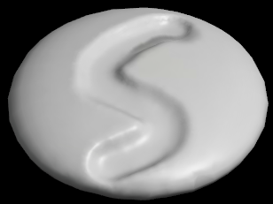

5.9. Step
Cuts into the surface on one side of the stroke and builds up the other side to make a step.
N.B. The direction of the stroke matters, for a step in opposite direction reverse the direction of your stroke.

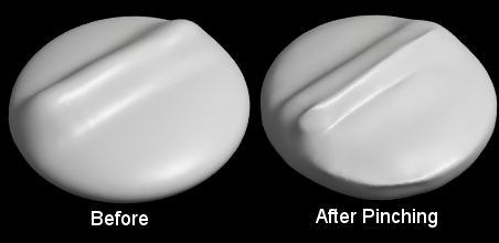

5.10. Pinch
Paint to Tighten and Shrink the surface along the stroke.
Pinch tool used on edges to sharpen them up

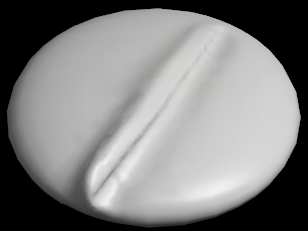

5.14. Flatten
Paint to flatten the surface.
Flattened Sphere
Use the Right Mouse Button to draw with the Flatten Tool to Flatten to View.
Paint to flatten the surface towards the current viewport.
Flattened Sphere

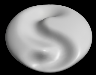

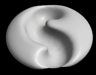

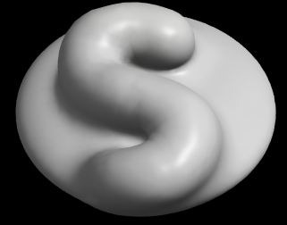

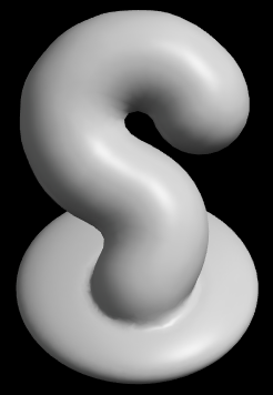

5.19. Pull Tubes
Drag out worm shaped extrusions from the mesh surface.

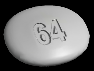

5.20. Custom Brush
Choose a (small) image to use as a stamp on your model. Click to place stamps of your image onto the mesh's surface.
You can reverse the effect and switch to an alternative stamping mode (Slice) in the options below the toolbox.

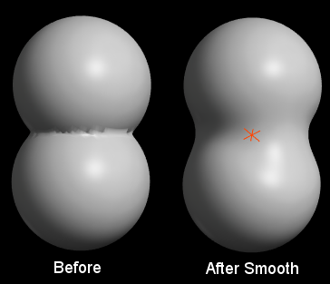

5.21. Smooth
Paint to smooth the surface. Elastic effect will tend to shrink the surface.

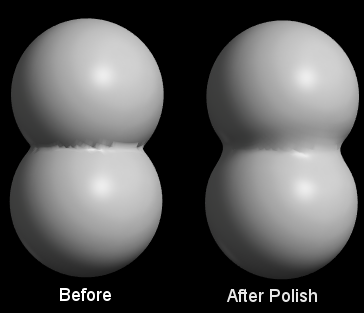

5.22. Polish
Paint to polish the surface. Improve surface curvature with little change to volume.
Polish has a more subtle effect than Smooth, fixing small defects while leaving the overall shape intact.

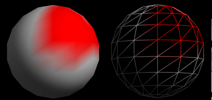

5.23. Paint Surface Colour
Colour the mesh vertices directly - does not need texture maps.
N.B. See the Painting Tools to alternatively paint texture maps.
Object shown above in wireframe (Press A) to demonstrate that surface colour is set at the corners of each triangle on the mesh. This is different to texture mapping which sets a colour at each pixel of the texture image.
When Automatic Subdivision is turned on Curvy will add mesh detail where you use a small brush to paint the surface.

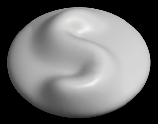

5.25. Pull
Drag part of a mesh to move it.
Use the Sculpt Tool Size to change the size of the effected area.

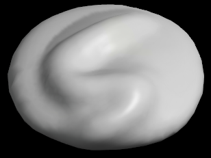

5.26. Local Rotate
Twists the mesh around a point as you drag.

6.1. Smooth
Smooths the entire surface of the mesh.

6.3. Polish
Smooths the curvature of a mesh making the surface more continuous.

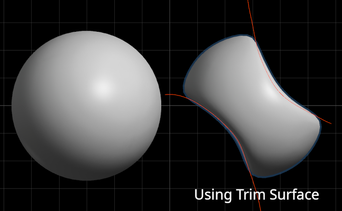

6.14. Trim Surface
Adds a Trim Action to this model. Now you can draw curves and the surface of the model will be clipped by the drawn curves. Try drawing from different view angles to control the effect of the trim curve.
